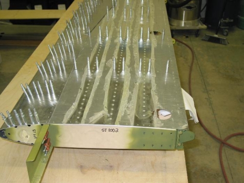

Brief Description:  LOOKS LIKE A PLANE PART
PUT THE SKIN ON AND CLECOED ALL THE RIBS WITH PRE DRILLED HOLES. THE SKIN IS THREE PC'S NOT ONE, LIKE THE INSTRUCTIONS SHOW. AS WELL I DRILLED OUT A RIVET THAT WAS NOT SEATED VERY WELL AND DRILLED IT OUT TOO BIG. THE FIX WAS TO INSTALL A BIGGER RIVET.
