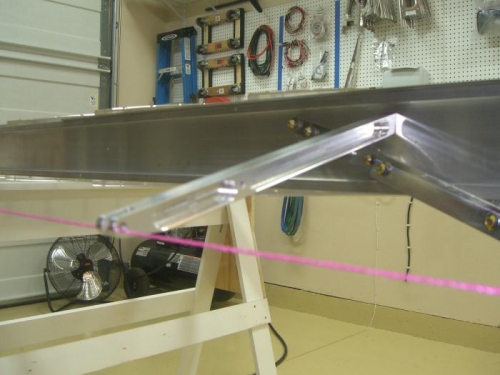

Attach Aileron Center Hanger
Attached aileron center hanger per manual, torqued bolt to 40 inch pounds, used red Loctite. Used alignment string per manual, squared bracket vertically to rear spar.
