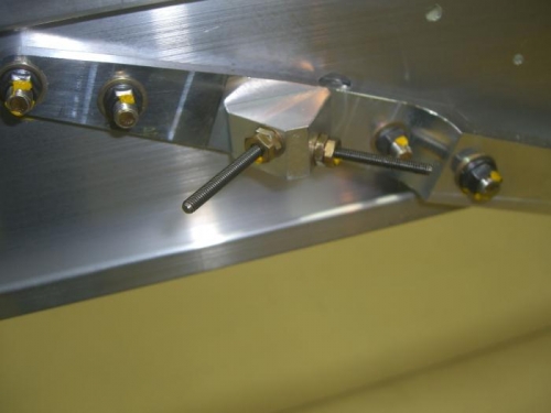

Brief Description:  Install Drag Wire Jam Nuts & Install Diagonal Cros
Rechecked drag wire tension, rechecked wing square at cross tube # 2, rechecked wing for straightness. Installed jam nuts on drag wires using red Loctite.
Completed Log & Inspection Sheet Wing # 5.
Trimmed diagonal cross tube, match drilled, deburred, installed hardware, torqued to spec and torque sealed.
Drag Wire Nuts
Drag Wire Nuts
