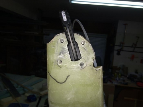

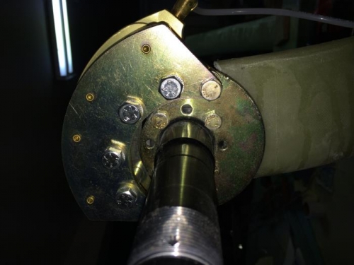

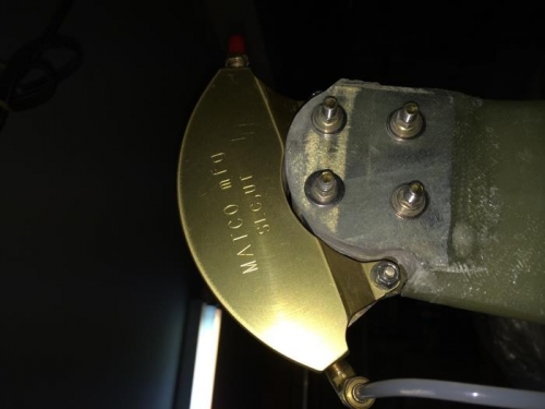

Recieved the brakes! Made a template to use for cutting the landing gear. Sanded flat spots on landing gear. Placed target on all in front of fuselage for setting toe in. once I was happy thith the allignment I clamped the axles in place and marked and match drilled holes. Using the templates I cut the gear leg to fit the brake caliper. Fabricated a backing plate from 1/8 inch 2024 and fiberglassed in place. let cure overnight. Next day checked fit and sanded/grinded leg to get a perfect fit for the caliper.
