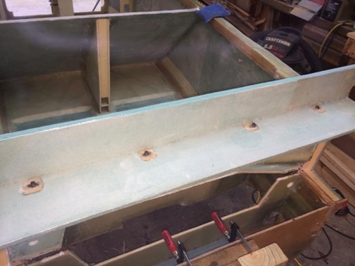

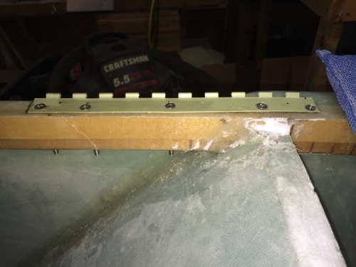

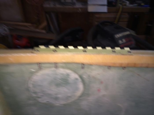

Seat Bealt Shoulder Brace
Fabricated shoulder brace from PVC foam and glassed with 2 layers BID. installed nutplate with flox. Cut canopy hinge to length and installed before glassing in shoulder brace.
