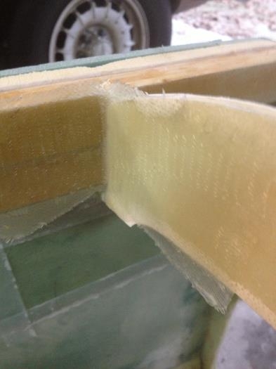

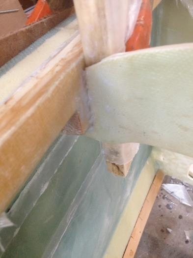

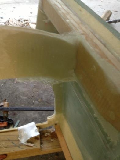

Installed F-28 bulkhead. Clamped block of wood on both sides of fuselage at the correct distance from F-22. Floxed in place and clamped for cure. After cure laid the required BID layers on aft side.
F-28 floxed and clamped
F-28 BID layers
F-28 BID layers
