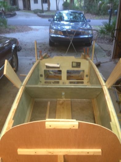

Date:  8-31-2013
Number of Hours:  4.30
Manual Reference:  Chapter 6
Brief Description:  Fuselage assembly
After rechecking all measurments and checking for level used nails and blocks to ensure everything could be disassembled and reassembled the exact same place. Disassemble everything and buttered flox on all joints. Reassembled parts beginning with seat back and working forward to F22.
Rechecked all measuremnts and clamped everything in palce.
