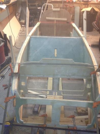

Date:  8-18-2013
Number of Hours:  4.00
Manual Reference:  Chapter 6
Brief Description:  Fuselage dry fit
Installed temprary firewall perfectly centered and adjusted so the top of the longerons would be at WL 23. Dry fit fuselage sides and F22. checked for level and adjusted as necessary. Realized the top 2X4 on the front of the jig was too long. Removed and recut then reinstalled.
