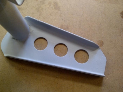

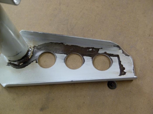

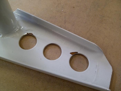

I noticed that the factory paint was chipped on the left elevator control horn, and the underlying steel was showing some surface rust. To address this, I chucked a wire brush wheel in the drill press, and removed all of the loose paint, and then all of the surface rust from the steel. The paint had delaminated from a fairly large portion of the control horn. With the loose paint removed, I used some 220 grit sandpaper to feather back the good paint edge and ensure that the exposed metal was clean. I then reprimed with Tremclad rust primer.

L. Control horn, chipped paint and surface rust evident
loose paint and surface rust removed
new primer coat applied.
