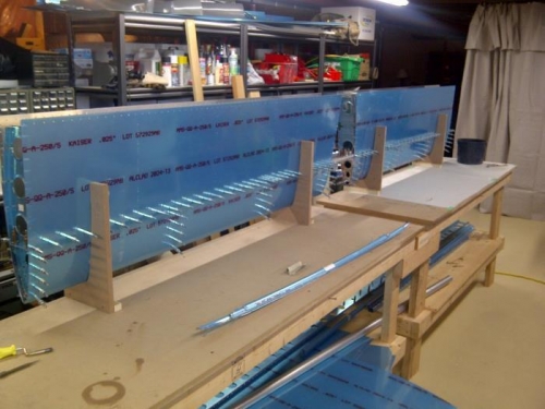

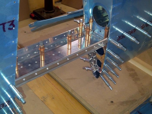

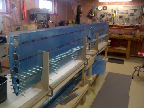

Matchdrilled the nose and inspar ribs to the forward spar, then deburred the HS skins and clecoed the nose ribs forward spar and inspar ribs into the HS skins.
Everything fit together perfectly. My efforts in rounding the forward portion of the nose rib flanges also seemed to work out well, becoase there is no hint of outward denting of the skins.
