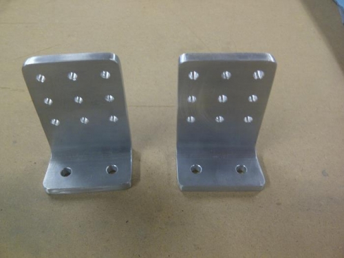

Brief Description:  atachment brackets, HS Spar caps and stiffeners
Re-checked the attachements for square, and lightly sanded some of the edges to bring the brackets into square. The results are generally good, but I have one edge I can't square without removing too much material. Generally I'm within 0.01 inch on all dimensions, so i do need to be careful. Best to leave well enough alone.
Trimmed the HS front spar caps and HS stiffeners on the band-saw, and then sanded and debured all of the edges.
This photo taken after match drilling to front HS spar
