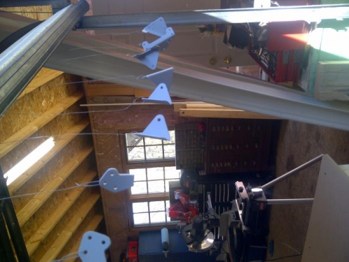

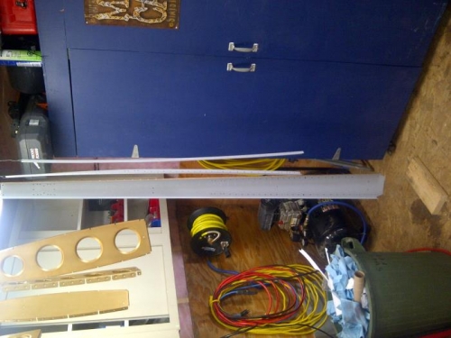

Brief Description:  priming VS skeleton parts
I decided that I would prime those parts of the VS skeleton that would be "out-side", and so would be exposed to weather and/or would eventually be painted.
All of the interior surfaces are left un-primed - alodine only.
The primer I am using is Tremclad Professional Rust Primer - flat grey. I am not using a self-etching primer since the alodine process already does that.
