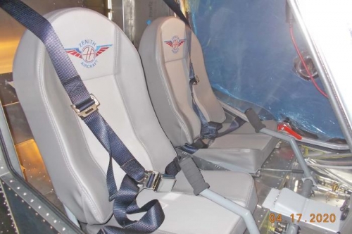

4/15/20
2.4 Hours
Installed seat belts that were make in Chian [sic] (don't know were that is). Filed and sanded on edges of right middle window to get it to fit.

Worked the whole time to get the ready to install torque tube end plate. Had to cut about 3/8" off the bottome of the 4130 steel torque tube end plate. The plans call for riveting the end plate angle cross piece into place but I will bolt with AN3s or willl never be able to get in belly crawl hole again Temp screwed belly hole cover into place in prep for weight and balance tomorrow.
Seat belts
Seat belts
