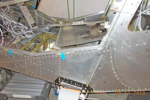

Brief Description:  Doors
4/17/19
2.2 Hours
Cut right door top tube to length. Clamped to hinge. Several more holes were predrilled in hinge than in the left. Back drilled through them then removed tube from hinge and layed out rivet line and pilot drilled. Put hinge back on tube, back drilled and up drilled to #30. Taped spacers to left door sill. Cut bottom door tube to rough length. Need a little shorrter to get proper clearance.
Lower door  tube
Lower door tube
