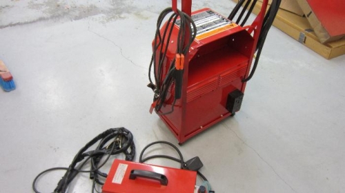

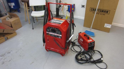

Brief Description:  Really finished welder and cutter setup
As I mentioned yesterday, my plasma cutter was blowing the 20A breaker on the 110V circuit it was on. I could only cut 3-4 inches before it blew. I managed to get that relatively small job done but I knew I needed to wire the machine to a 220V power source if it was going to be effective on a larger job (like the upcoming jig). I was going to buy a new long cord like I did for the welder when I realized that I could just share the welder's new cord. I added an outlet to the welder's case. Now, wherever I'm welding I'll also have power for the cutter. Since I'll usually be using both (but not at the same moment), it should work out fine.
