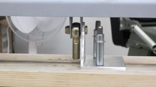

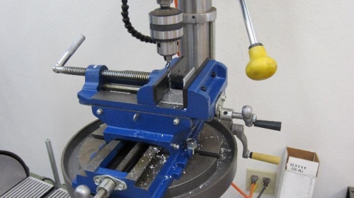

My first job today was to make and install brackets onto the jig for mounting the HS rear spar along the hinge line. Using my new cross-slide vice made it relatively easy to achieve a constant height above the mounting surface (and therefore a straight hinge-line).
cross-slide vise in action
a jig hinge bracket
a jig hinge bracket

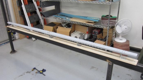

HS spar on jig
HS spar on jig
