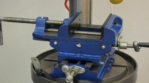

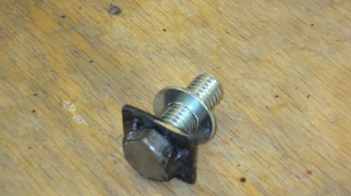

I bought a cross slide vise for my drill press to get better accuracy on certain drilling jobs. I had to make t-bolts since Harbor Freight doesn't seem to carry any.

cross slide vise
cross slide vise
t-bolt
t-bolt
