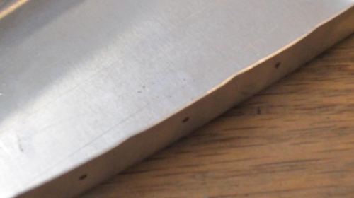

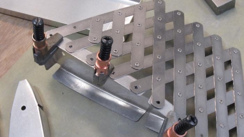

I'm starting to flute the HS ribs. To do this, you begin by planning the approximate locations for the rivets. This takes a bit of careful staring at the plans and visualizing how everything goes together. Note that the plans give some leeway on exact rivet placement. Particularly, I found that the example placement shown on the drawings doesn't really work.
Rivet fan to give even spacing
Flutes between rivet holes
