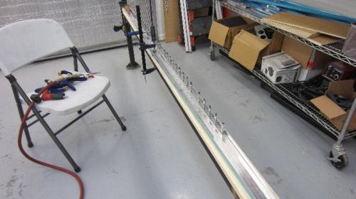

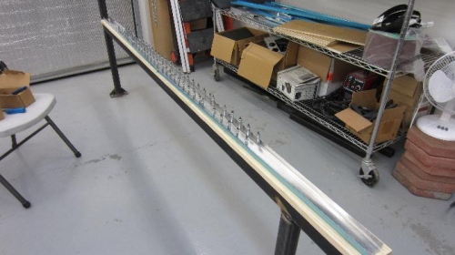

Match-drilled HS spar strips
I figured out where the spar strips needed to be touched-up in order to fit the webs properly. I've now got about 1/32" margin over the 2 7/8" minimum spec. When I had the spar strips in the right place, I match-drilled them to the spar webs.
