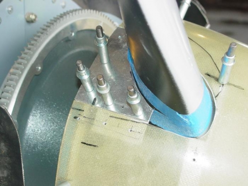

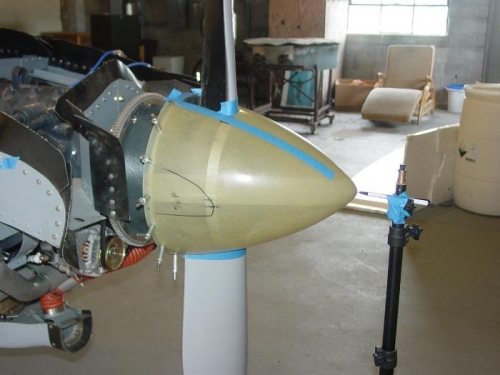

Drilled holes in spinner mounting it to the prop a
Drilled the spinner to the prop and bulk heads after makeing sure the spinner was square with the prop. I then made the filler plates for the spinner.
Makeing sure the spinner was seated and not out of round.
Makeing one of the filler plates for yhr spinner.
Locating the filler plate on the spinner.
