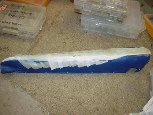

Fixed the bottom rudder fairing.
The lower rudder fairing was cracked along the bottom seam, I filled the seam with duraglass and after sanding I put two layers of fiberglass on and sanded, after priming it turned out very nice.
Glass layup of the duraglass

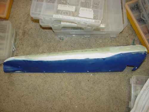

After sanding,

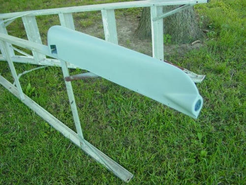

After priming.
