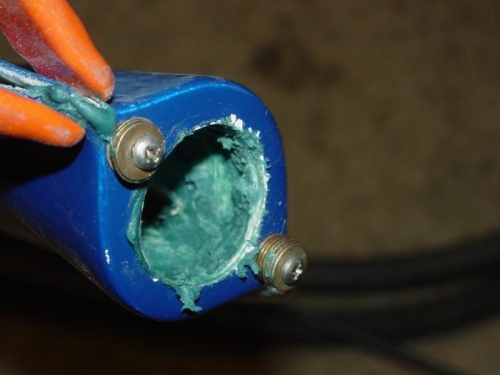

I located on the rudder fairing where the light strobe combo will be installed, after drilling the screw holes that will hold the light in place I duraglassed the nuts in place so the light could be removed at a later time for repair or replacement.
Drilling the hole in the fairing for the light.
Duraglassing the nuts into the fairing to hold the light in place.
