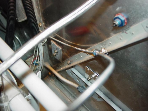

Located and installed the heater cable through the instrument panel. I then cut to length the cable and the cable wire. I also secured the cable to the firewall brace with an adel clampso it would be better secured, where the cable goes through the heater door bracket will be secured with safety wire.
Drilled hole in instrument panel and installed the heater cable.
Installed an adel clamp on the firewall brace to hold the cable as it turned towards the heater door.

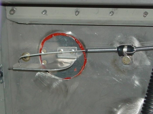

Hooked up the heater cabl;e to the heater door. Need to saftey wire the cable to the door bracket.
