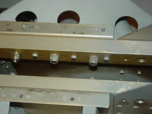

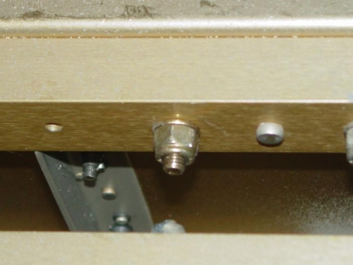

Brief Description:  Changing bolts in venter section.
Changed the bolts going through the center section from AN4-12A to AN4-13A's as they were not long enough., also routed some of the wireing fro the instrument panel.
Bolts in plans called for an412A but the did not go through the nut.
I replaced them with an4 -13A bolts.
