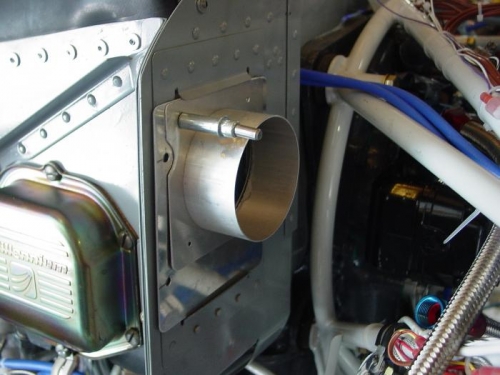

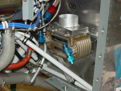

Mounted the oil cooler.
Mounted the bracket to the back of the baffeling and the one on the oil cooler and then tied them together with the scatt tube.
Bracket with tube to fill the hole in the back of the baffel wher the oil cooler used to be mounted.

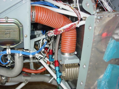

Here is the cover that is mounted over the oil cooler.
Here is the scatt tube mounted to bothe pieces
