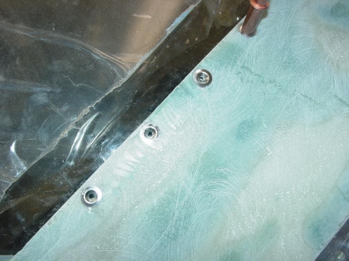

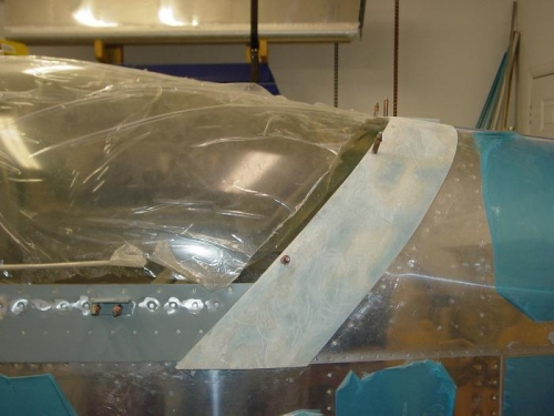

Sanded the canopy skirt untill all the low spots were filled, I then glued #6 countersunk washers into the rivit holes where the skirt mates to the canopy, tomorrow I will put two layers of fiberglass on the skirt at the same time covering the washers, I think this will give it extra strength when I rivit it to the canopy.
Sanded the skirt the blue spots show where it had low spots.

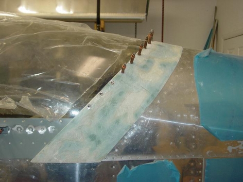

Glued #6 counter sunk washers for strength where the rivits will mate to the canopy.
Clecoed everything together to let the glue under the washers dry.
