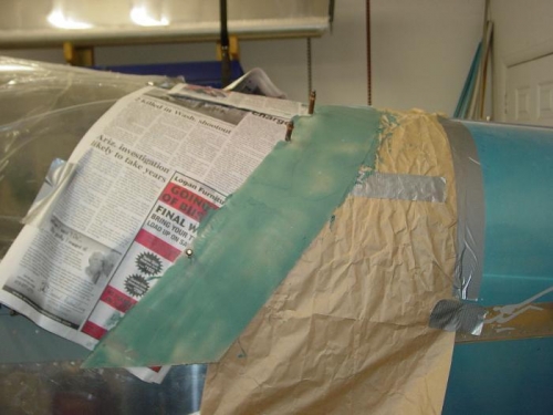

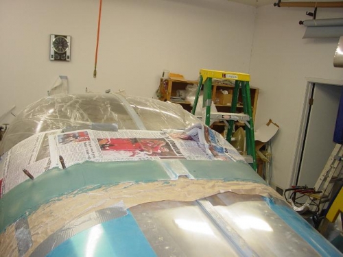

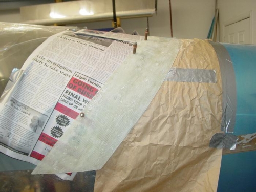

Brief Description:  Working on the canopy skirt to make it a straight
Sanded the canopy skirt with a da sander to get the high spots down, I then put a coating of duraglass on the surface, I will sand it down tomorrow to get as flat as surface before I put the last layup of fiberglass on for the final finish.
After sanding.
After sanding.
Applied  a coat of duraglass.
