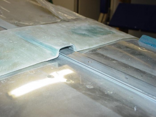

Worked on the rear skirt of the sliding canopy where the skirt goes over the canopy rail. It had several low spots that I filled in with duraglass, came out ok. I will finish by laying down one layer of fiberglass over the skirt.
Filled in with duraglass.
Shaped with a piece of wood and sandpaper.
Here is the final fit with the low spots filled in.
