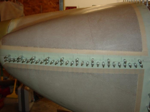

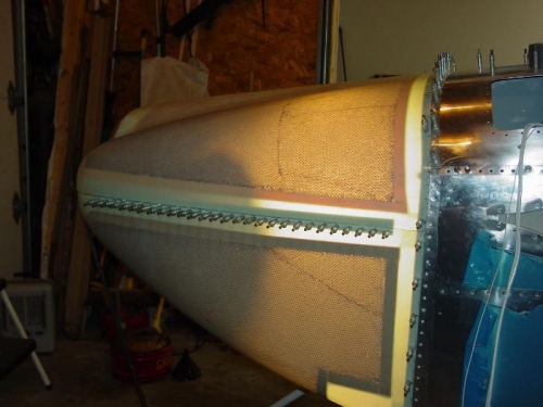

Mating the top- and lower colwing to each other.
I located and clecoed a piece of alum strip to the bottom cowling, I then fit the top cowling and drilled and clecoed where the #6 screws will go.
You can see clecoes holding the strip between the two halves.

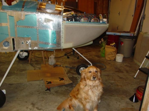

Here you can see the lower half with the strip clecoed on,along with the RV dog.
Here you can see where the screws will be located to hold the top cowling on.
