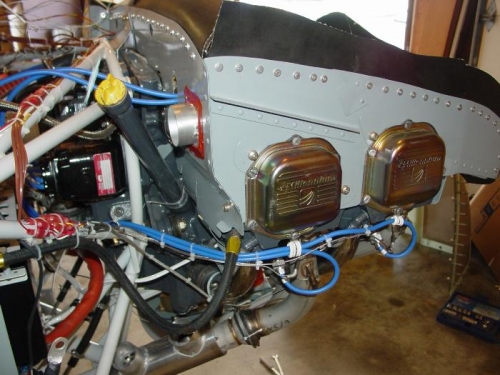

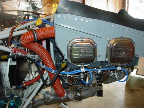

Running scat tube to heat muff.
Cut a 2" hole in the back of the baffeling to run my scat tube from to the heat muff.
Cutting the hole in the back of the baffeling..
Rivited on a piece of 2" tubing.
Ran the scat tub from the baffelinjg to the heat muff.
