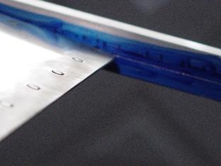

Brief Description:  Setting ailerons to the neutral posetion
Put the aileron lock on the bellcrank and alined the aileron with a templet mounted to the edge of the wing to set the neutral posetion of the aileron. I then tightened the lock nuts on the control rods.
Here is the templet mounted to the edge oh the wing.
Here is the aileron lining up with the line on the templet.
