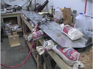

Final assemble of the left flap, noticed the trailing edge was wavy, called Van's and they advised to mount a piece of angle iron on the work bench and drill and cleco all the trailing edge holes to it so you don't have the wave anymore.
Saddel to hold the flaps while you buck the rivits.

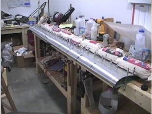

Riviting the leading edge on.
Finishing the leading edge on the bottom of the flap.
