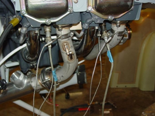

Brief Description:  EGT wire leads instaled.

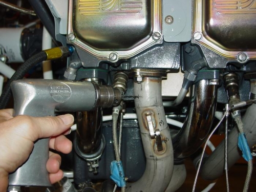

Installed EGT wires into the exhaust pipes, I found it diffacult to get a answer on the exact location down from the cylinder port that they should be located, but that they should be the same distance on all four cylinders, So I located the probe at 1 1/8 inch down just before the bend in the exhaust pipe on the #1 cylinder, and made all the rest the same.
Drilling 1/8 hole for EGT lead.

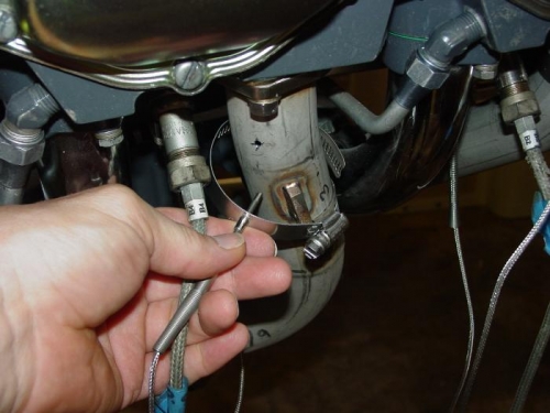

Instaling EGT lead into hole in exhaust pipe.
Installede EGT Leads.
