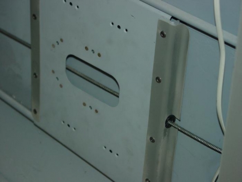

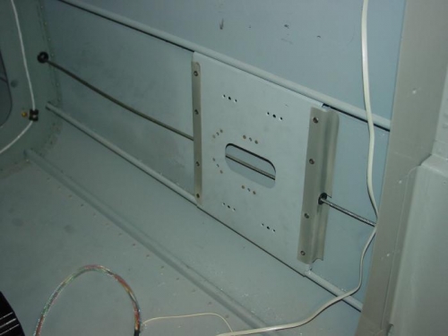

Brief Description:  Reinforced elt bracket.
When I installed the elt bracket some time ago I was unhappy with the strength of the sidewallas I had to trim part of it away for the rudder cable to pass behind it. So I installed a stiffner to both sides of the bracket with a plastic gromit for the cable to pass through.
