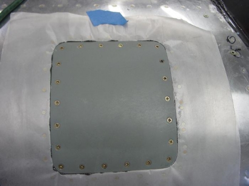

Brief Description:  Making gaskit for my access panels.
Took the three access panels and put pro seal on the back of them, I then put wax paper down and screwed the access panels down to form a gaskit. After it drys it will be a water tight seal for the access panels.

Panel screwed down to spread out the pro seal to make a gaskit.
