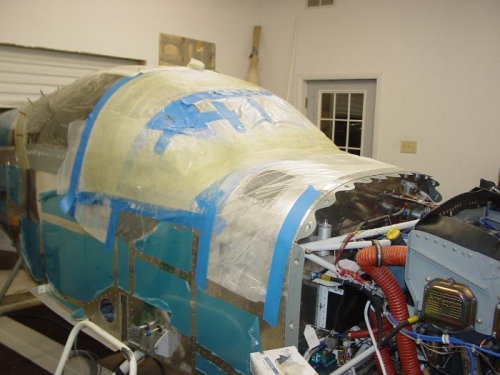

Brief Description:  Applied the fiberglass for the windshield fairing.
Applied several layers of fiberglass for the windshield fairing. I also applied the ply and peel at the end for a much smoother finish and hopefully less sanding.
This is the first couple of layers of fiberglass .

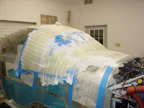

Here is the final layup of fiberglass.
Here I have applied the ply and peel to the fiberglass for a smoother finish.
