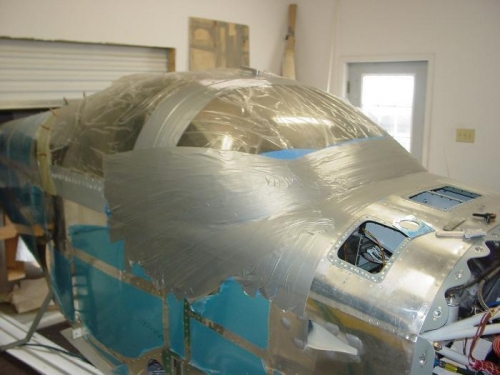

Taping off for fiberglass
Taped off the windshield and sliding canopy so I can start the fiberglass layup.

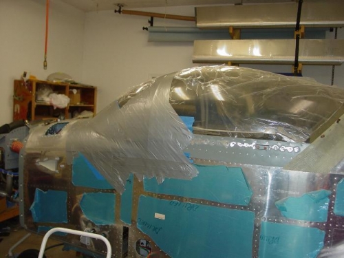

I put a layer of paint tape down befor the duct tape.
Here is the left side of the fuselage layered in duct tape.

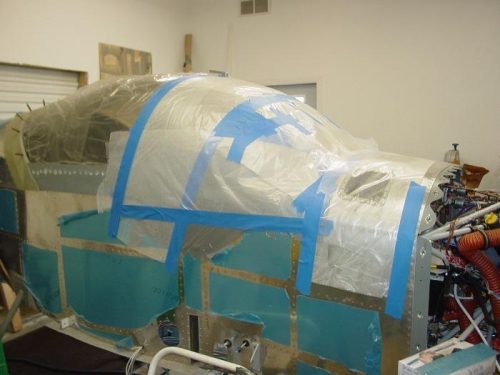

Here I put down a layer of wax paper as a release agent for the fiberglass.
