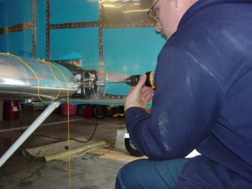

Brief Description:  Drilled the fuel tank attach brackets.

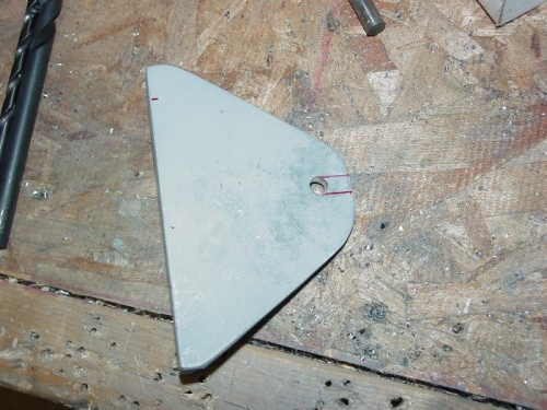

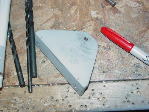

Made a bracket that will attach to the fuselage and then bolt to the fuel tank bracket to tie the two together, the fuselage bracket is notched so in case of an accident the wings will pull away through the notch.
Here I am drilling through the fuel tank bracket and the fuselage bracket.
Here is the fuselage bracket before being notched.
here is the bracket after being notched.
