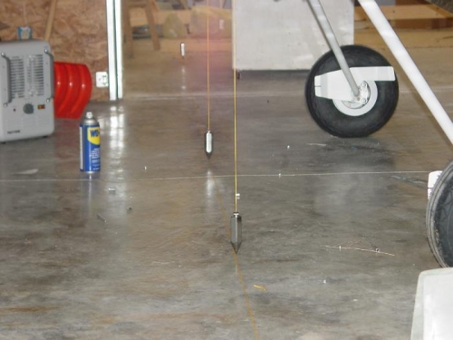

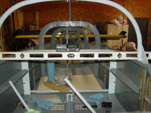

After mounting the wings and leveling the fuselage side to side I put a plumbob on the outer edge of both wings and one on the inboard edge of both wings and then put a string on the floor lining it up with the two outer plumbobs to see if the wings wwere straight and they were. We then measured from the tip of each wing to a central point on the rear fuselage and both measurements came out the same.
Here I have leveled the fuselage side to side.
Here are the plumbobs showng the swaap of the wings is right on.

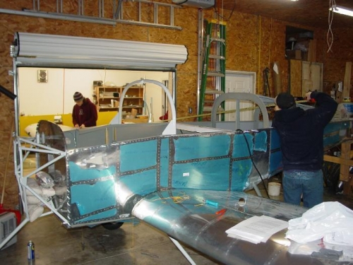

Here Jake and I measure from each wing tip to the fuselage to see if the wings are square.
