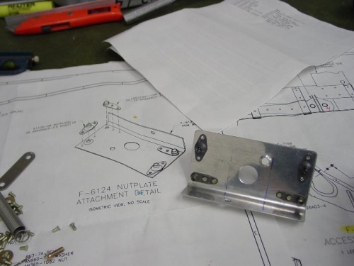

Brief Description:  Finished the manual trim bracket.
Finished the manual trim bracket by first drilling the pivot bracket to the bracket, then drilling the bracket to the floor panal, and finished by riviting the nut plates to the bracket so it can be mounted to the floor ribs.

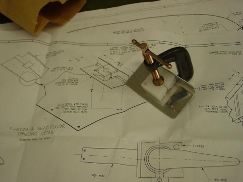

The pivot bracket matched drilled to the manual trim bracket.
Here the bracket is match drilled to the floor pan.
Here is the bracket with the nutplates rivited on.
