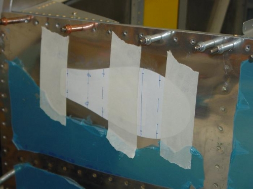

I located the pattern on the outside of the fuselage and drilled the rivit holes, I then located the NACA vent on the inside and deilled through them useing the rivit holes as a templet.
I have laid a templet on the outside of the fuselage.

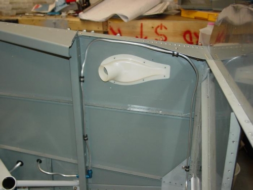

Here is the fresh air inletmounted on the inside of the fuselage.

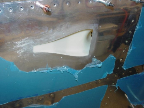

Here is a view from the outside
