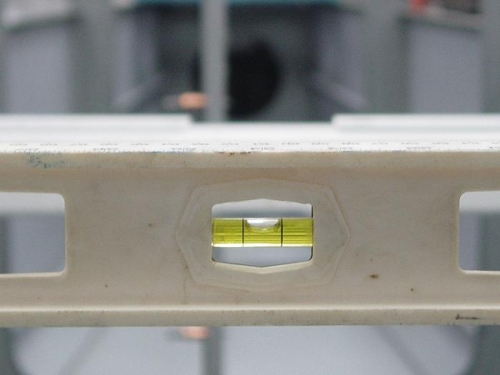

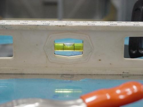

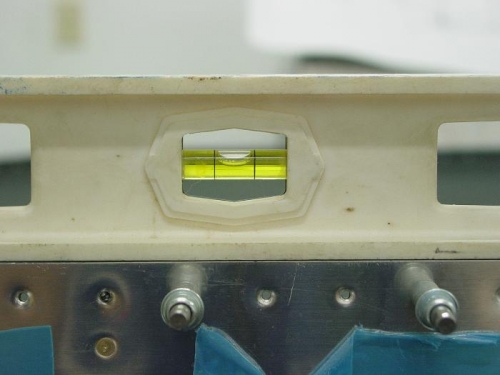

Squared the fuselage and drilled the rear deck pla
We turned the fuselage over and it was then levaled before I drilled the rear deck plate to the longerons.
Here you can see the longeron on the side of the fuselage at the center secrtion is leval
This showes the center section being leval from side to side.
This showes the rear deck plate being leval before I driiled and clecoed it to the longerons.
