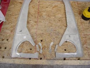

Making shims and working on the seat ribs. I had to open up four of the ribs so the contro stick would work without obstruction, I then had to remove the top section of two of the ribs so the control stick can be removed without a problem.

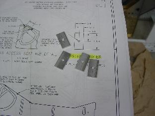

Here are the shims that will locate behind the seat ribs.

Here are two seat ribs with sections removed to fit the control
