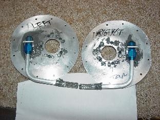

Brief Description:  Fuel tank endplate.
Riviting on the nutplates and the antirotation bracket on the endplates. Also installed the fuel pickup tube. The reason I made these new fuel tank endplates with the float system is the capacative fuel sender will cost $500. or more for the fuel gage
Here are the two endplates with the fuel pickup tubes.

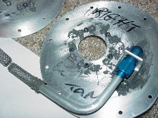

Showes the anti rotation bracket with the fuel picup tubes.
Put plenty of prseal on to prevent leaks.
