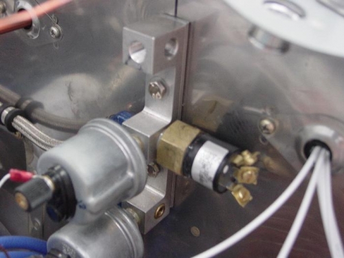

Added a hobbs meter along with a led warning light. The sending unit for the hobbs meter also sends a signal to the led light when the pressure goes below 15psi, at that time the light comes on.
Hed to put a spacer behind the manafold so the hobbs sending unit would fit.

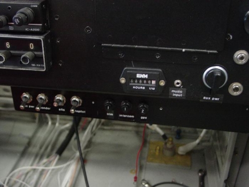

Mounted the hobbs unit.

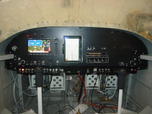

You can see the light in the upper lafe corner comes on when the power is on .
