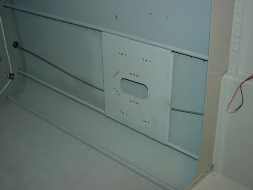

Brief Description:  Mounted strobe and elt bracket.
Mounted the strobe and elt bracket I recieved from Vans.I mounted these brackets per Vans plan and because the bottom four rivit holes on both brackets were on the bottom stifner I had a very hard time pulling the rivits, if i had to do it again I would rivit them to the longaron and the middle stifner.
Mounting platenuts to the strobe and elt brackets.
Mounted the strobe and elt bracket.

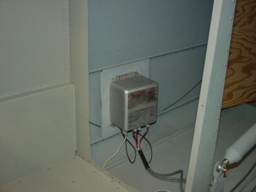

Mounted the strobe unit to the bracket.
