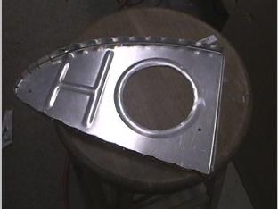

Took the inboard rib and cut a 6" access hole and drilled the holes in the rib for the T-407 rerinforcement ring for the T-408 tank access plate to bolt onto.
Cut the 6
Cut the 6" access hole in the inboard rib.

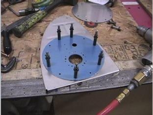

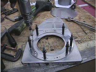

Useing the access plate to locate the holes in the rib.
Locating the reinforcement ring on the rib.
