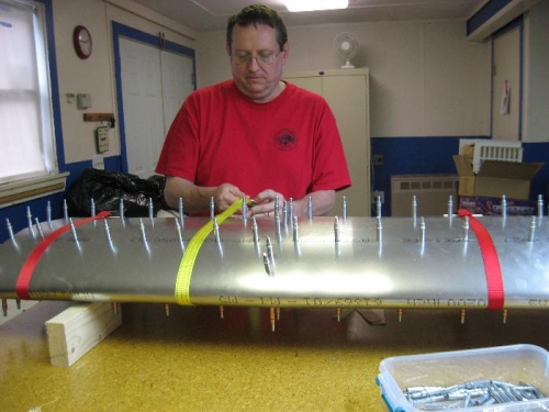

Attached skin on horizontal stabilizer
Today we attached the back side of the skin and drilled out all the holes. It was attached with 8 straps to pull it tight to the skeleton before drilling and clecoing.
Tightening the straps

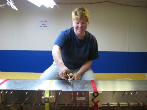

Clecoing the skin
Clecoed in place
