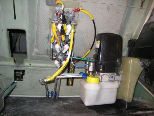

Brief Description:  Installed Aft power grid
Customized special fibreglass channel mounts and bonded them to back of copilot seat close to hydraulic pump. Aft power grid was thus mounted using clickbond floating nut plates. This particular installation saves the additional wiring run from the pump to the aft grid via a terminal block which is now no longer required.

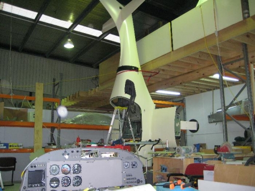

After bonding battery box
Aft power grid
Aft power grid

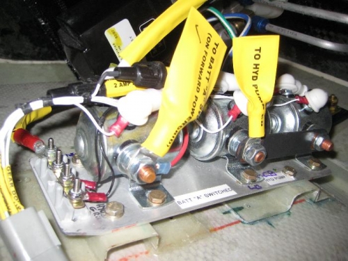

Master Solenoid and Gear Relays.
