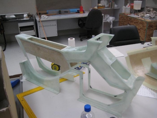

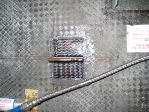

General trimming of center console. Fabricated the hydraulic line locator/brace out of a phenolic block and sandwiched it with a layup of cabon fiber and bonded it.

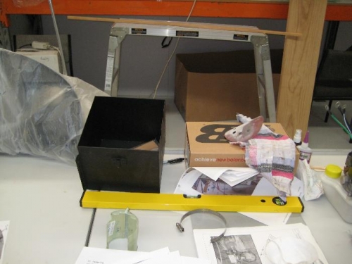

Investigated the battery box and its fibreglass mount and realised that it will need redesign and customization to clear the elevator control tube.
Center console.
Center console.
Hydraulic line locator
Battery box
Battery box
